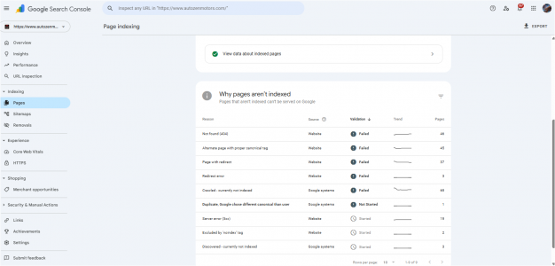

Hello. Im looking for any type emergency advice or guidance for my traffic loss in September. By now I realized my devastating keywords rank and real traffic loss is due to serious issues with my website, which is from CarsForSale.
Im in a new location, from October 2024 which sort of reset my SEO in a first place, and then Jan 2025 I hired an SEO "pro" from fiverr for my to BUY-HERE-PAY-HERE keywords, which I specifically told him not to use and shared my "good keywords," despite from January having bhph customers constantly calling/walking. In April I noticed increase in good traffic and sales. from april to august 2025 while still ranking in top 3!! for BHPH, that I cant convert, my "good' keywords were ranking stronger and stronger! July was peak and august was still good but started to slowdown. Then in September, It's like lights turned off.
At first I thought it was "seasonal" and Im a small dealer, just moved in to real lot, and before that for 8 years operating basically as online by appointment with no real display area and no exposure. So in July I sold 14, August 7, Sept 1. but the main thing is ALL traffic stopped - even bhph walk-ins, calls etc. I started to check SEMrush, google search console and basically saw correlation with aug 26-sept 22 Google spam update. All graphs perfectly align! GSC has a lot of errors non indexed pages 5xx, 404 etc. CarsForSale refuses to fix it.
I've sent them all data , few times, to their managers ,on jan3 they even asked me if they can add someone from engineer dep to my google search console to "look closely"- to this day nothing fixed. my VDP pages keep been non indexed, other errors google keeps checking only to see that its still broken.
I tried to optimize content in gbp, and website to distance form bhph and get back my used cars keywords. with no luck. I still rank for bhph strong.
at this point Im looking for best what I can afford website dealer platform all in one, I know it snot best. Please any help is appreciated very much.
Ive done all my research myself and spent months, SEO people I talked to ignore my research and want to start a paid service, which is not professional IMO.

You didn’t lose traffic because of a Google update.
You loss traffic because of CarsForSale I was looking at one of their sites not long ago and they had blocked VDP's and your VDP's are not getting indexed, not saying they blocked them but ...
And it doesn't look like the site has any real content on it, do you have a link to the site?
To do list to recover:
1. You have to fix server errors first because Google can't crawl the broken site.
Pages could be timing out which is a page speed problem and if they can't fix it you need to move platforms ASAP.
2. Fix all the 404 Errors and make sure the new platform doesn't remove cars when they are sold, mark them as sold and keep them on the server or redirect old VDP to a similar car or to the inventory page.
Better is to keep page live with “Sold See similar cars” that way you keep the SEO juice.
3. Fix Canonical Issues duplicate VDP pages kill indexing. Same car on multiple URLs redirect www to non www.
4. Fix Redirect Errors. No redirect loops, No chains,
5. Get all your VDP's Indexed. If they aren’t indexed it will kill your SEO.
Each VDP must have:
Unique title, 300+ words description, VIN structured data, Local schema, and Internal links.
6. Kill Wrong Keyword Associations, Remove: “Buy Here Pay Here”, “Bad credit financing”, “No credit car loans” from titles, headings, Meta descriptions, content, and then build pages for real buyers “Used Hyundai Elantra city”, “Low mileage trucks city”, “Best used SUVs under $15k city”
Google must relearn who you are.
7. Build Real SEO Pages. Dealer sites fail because they rely only on inventory. You need content pages.
Examples:
“Best Used Cars Under $10k in City”
“2018 Hyundai Elantra Reliability Guide”
“Common Problems With Dodge Charger SXT”
“Used Truck Buying Checklist”
These rank even when inventory changes.
This is where you win.
8. Fix Local SEO Update NAP everywhere, Get 20+ local citations, Get 10 real Google reviews, Post weekly on GBP, Add photos of lot.
9. Improve Site Speed, Dealer platforms are slow. You must pass Core Web Vitals.
Use Google Lighthouse slow VDP pages don’t rank.
10. Build Backlinks
If CarsForSale refuses to fix server errors and indexing issues…

I missed the link in the image :dunno:
I did site:autozenmotors.com to see what Google had indexed...
Tons of thin category pages
Almost no real content
Almost no valuable VDP pages
Duplicate-style pages everywhere
Examples:
/mazda-for-sale
/wagon-for-sale
/pickup-for-sale
/referral
/faq
/schedule-test-drive
These are template pages with 50 words of content. Google sees: This site has 200 low-quality pages. So rankings drop.
Look at this pattern:
/toyota-for-sale
/ford-for-sale
/chevrolet-for-sale
/cadillac-for-sale
/lincoln-for-sale
These pages only exist to stuff keywords. They don’t rank. They dilute the site. And VDP pages are barely visible. Vehicle Detail Pages should be your most indexed pages.

Man, thank you very much! Just found the notification! You are 100% correct its not because of Google update bad, its the carsforsale, Im just now looking to make a right switch, but its been hard to make a decision, because now I constantly check website of potential providers by checking “ builtwith” to see if I can find some info about their technology. And I even do seo audit on those website just to compare to mine with more than a 1000 issues all together. At this point Id really love to find seo specialist who would help with even just initial steps for recovery, sort maybe one month session, because all seos I talk to they just want to start regular process. I really appreciate your thorough input, I have gained seo gsc knowledge, and I know that I had good metrics supported by actual sales till the very end of august. My mistake is i tried to figure this all out myself for months, but now if could afford such service Id do it.
Now I have acciunt withDEALER CENTER just for financing part i want to grow, so its easiest route to get website through them. But please can You or anyone advice if I explain them this repair plan, they would be actual logical immediate move? Ive talked to them already few times, but Im not sure if they would understand completely.
I really stuck in this deciion fatigue everyday lol. Checking providers , analyzing websites, when Im the only operator, besides mechanic( still Im the one who does complex diagnostics online for rovers jags etc) I need to put my energy to the floor,
Im really hard fighter worker, but this takes all my mental energy at the moment.

This is ongoing disaster. This template is my recent request to cfs in hopes to reset some errors. Even though I kept aksing them if someone could advice if new template would even do anything. They never adviced. I knew that its will reset even more, requested at least if they can adjust my seo while making new template, considering my situation, explained thoriughly. They didnt do anything , gave me plain template, and I had to once again with my limited knowledge try to optimize content, at least for related keywords and try to distance from buyherepayhere. All the titles etc is me. And funny thing I never had bhph in my content for 8 years, then in new lot i tried fiverr seo person and he didnt listen and used bhph kw in gbp and i think trashy bscklinks, so i told him to fix it so there no bhph already for more than 1 year. I kept checking , but i still rank even stronger, I need help lol.

I think a big part of this is actually your sitemap - it's telling Google specifically which pages to index.

After CarsForSale, the biggest mistake dealers make is switching providers without checking two things first:
  1. URL structure + redirects
    Before you move, export every indexed URL (from Search Console + a site: search) and 301-redirect them. Otherwise you lose whatever trust Google still has in your site.
  2. Page speed + code quality
    Many dealer platforms generate thousands of thin pages with heavy code. That’s exactly what usually causes traffic drops.
You also want to keep building real content on the SRP pages Google already knows about and not delete them but rather improve them so they aren’t thin.
And honestly, it’s worth considering a setup where your site isn’t identical to every other dealer template. That helps long-term rankings a lot.
If you want, send me some of the example sites and I’ll try and show you what to look at before deciding where to move.
